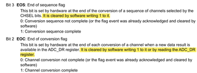

> ADC1->ISR &= ~ADC_ISR_EOS;
This clears all flags except EOS. If you want to clear EOS:
ADC1->ISR = ADC_ISR_EOS;
2024-12-12 11:06 PM
Oh wow, thank you!
