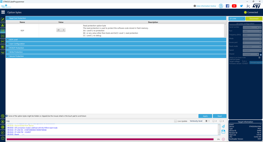

I am using the Readout Protection Level 1 security method for the STM32G431 chip. However, after flashing the code, it doesn't work, and when I use the STM32Programmer software to check, I encounter an FF error like this. Can anyone help me with this issue?

As the text on the screen goes: any RDP value other than AA or CC should be interpreted as Level 1. So your FF means Level 1, as you've set it. Can you guess why CubeProgrammer cannot read back the code now?
If the code does not work and you want to debug it - do not set RDP1 yet.
