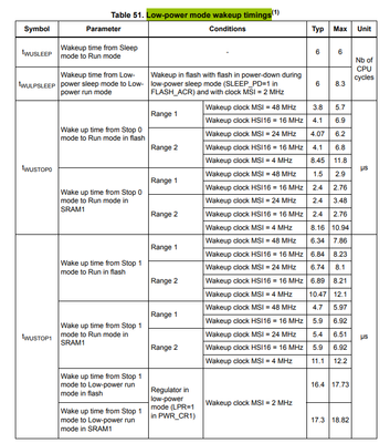

hello @MVeen.1
there is a point that I want to clarify,
I see that you are focusing only on the HSI wake up time.
Based on the datasheet, the wake-up time from Stop 1 mode (which is the process from the start of the wake-up process to the execution of the first instruction) is set to a maximum value of 8.1 µs when using flash memory. This time includes the 6.2 µs required for the HSI to start and stabilize, as well as the time needed for all other peripherals, including UART.
So, the question should be whether the 8.68 µs window is sufficient for the entire product to wake up from the start time and to reconfigure the clock again, not just the HSI. To address this, the 8.4 µs maximum value is guaranteed by characterization results based on the datasheet. Therefore, and if reconfiguring the system clock again does not take more than the time left. it should be sufficient as an expected behavior.
You can run tests and provide feedback in case you encounter any issues.
here is the low power mode wake up timings for reference
I also want to point out to you the section "Determining the maximum USART baud rate allowing to wake up correctly from Stop mode when the USART clock source is the HSI clock" in the reference manual
you need to do your calculations and verify if your UART can handle 115200 baud rate in your conditions
Hope that helps

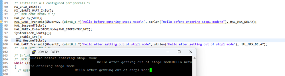

hello @MVeen.1
I recommend waiting the full 6.2 µs as the datasheet states to ensure that the clock has sufficient time to start and stabilize.
For your second part, I did not understand if you are asking whether it is doable or if you have already completed it and have the project working.
Just in case, I tried replicating your case on my end, and it worked successfully using the 115200 baud rate.
I am going to attach the code snippet that I used along with a screenshot of the results hoping it will help you
MX_GPIO_Init();
MX_USART2_UART_Init();
/* USER CODE BEGIN 2 */
HAL_Delay(5000);
HAL_UART_Transmit(&huart2, (uint8_t *)"Hello before entering stop1 mode\n", strlen("Hello before entering stop1 mode\n"), HAL_MAX_DELAY);
HAL_SuspendTick();
HAL_PWREx_EnterSTOP1Mode(PWR_STOPENTRY_WFI);
SystemClock_Config();
__enable_irq();
HAL_ResumeTick();
HAL_UART_Transmit(&huart2, (uint8_t *)"Hello after getting out of stop1 mode", strlen("Hello after getting out of stop1 mode"), HAL_MAX_DELAY);
/* USER CODE END 2 */
Gyessine

hello @MVeen.1
Hope that helps
Gyessine
