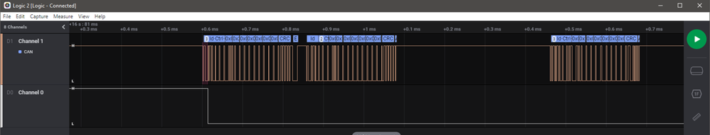

The corresponding interrupt is triggered and evaluated by me in the SCE handler. As a test I switch a GPIO only if the corresponding interrupt bit is set (see below) Channel 1 is the CAN_L and Channel 0 (below) is the GPIO-Signal.The first message is the message which is waking up the MC. Close behind is the repetition of the message because of the NAK. The second message gets a proper ACK. The third message is the reply of the microcontroller. Below the CAN_L line you see the GPIO which is getting switched off when the Interrupt Handler is called. This happens ~9 µs after the first edge.

All right. That would make sense. So the microcontroller would detect the activity on the bus and then wake up, but just too late and miss part of the message. Only with the repetition it gets the whole message.
That means, if there would be another device on the bus, which would take over the ACK, then the microcontroller would miss the message in the current configuration, because the message would not be repeated.
I have tried this and connected a random CAN-Device. In deed, it is like this. It wakes up but without repetition my sleeping MC sends no answer.
Thanks for the help @Community member, @Community member. Both of were right. The wake-up time is too long.
