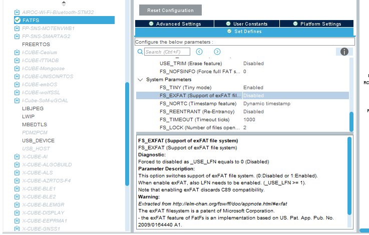

2024-05-20 2:54 AM
Thanks for your input!
During further testing, as per below snap,
STM32CUBEMX doesn't have an enable selection to use exFAT with STM32F407VET,
Does this limit our read/write operation on the memory card to 32GB(With FAT32) only?
2024-05-20 3:14 AM
No. Cards up to 32GB can be FAT32 , no problem . (Just check, whats on the card you use, or format it.)
Maybe you try : tiny mode -> disabled . (exFAT is not "tiny" ...) Then see...if possible.
