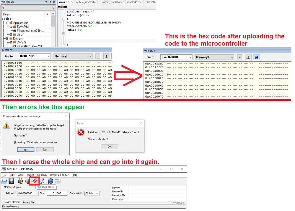

Why is access to the Microcontroller broken after this code?
The MODER register after this code should look like this: 00000000000000000000000000000011
this is Analog mode for pin 0 of port A.
int main(void)
RCC->AHB1ENR|=RCC_AHB1ENR_GPIOAEN;
GPIOA->MODER=0x3;
while (1)
Same but with port B or C does not throw an error
RCC->AHB1ENR|=RCC_AHB1ENR_GPIOBEN;
GPIOB->MODER=0x3;
RCC->AHB1ENR|=RCC_AHB1ENR_GPIOCEN;
GPIOC->MODER=0x3;
Port A is compatible with Analog mode
A user button is connected to pin 0 of Port A, but it is not pressed, which means it does not interfere with the execution of the code.

You are disabling the SWD pins PA13 and PA14. Look at the GPIOx_MODER reset values at the reference manual.

Exactly)) Thanks.
