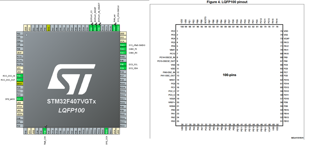

does not look that incompatible to me

2023-03-17 3:57 AM
thanks. this way works better and i get some error messages and can import the project
it seems like CAN was the problem. the H7 has no CAN only can-fd and this was reported as error and seems to mark it incompatible although normal CAN is possible
