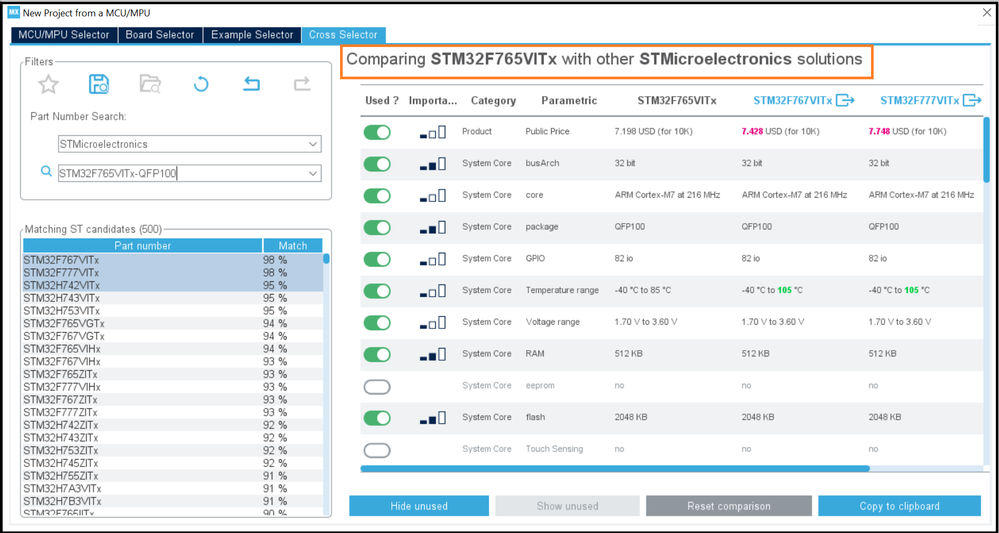

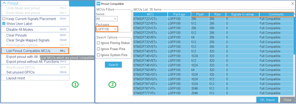

As mentioned by @Community member , CubeMX allows you to know the list of MCUs with Pinout compatible, you just need to start by creating a new project using your MCU part number (STM32F765VIT6 in your case) and press ALT+L to get the list of all compatible MCUs as presented in the image below:
In addition to that, CubeMX offers to their users a way to compare two or more MCUs and all that under the Cross Selector:
Hope my answer helped you, when your question is answered, please close this topic by choosing Select as Best. This will help other users find that answer faster.
Thanks for your contribution, Khouloud
