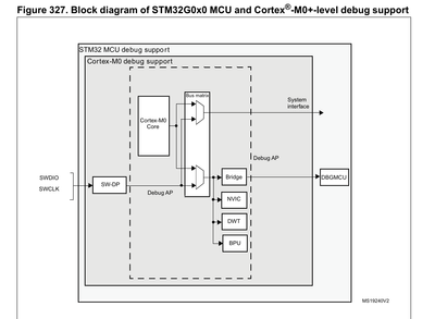

From rm cortex M0+ :
Here is no ITM.
2025-03-21 2:25 AM
It's a Cortex-M0+ - it has no ITM:
