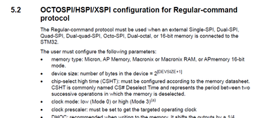

Is the Quad mode enabled on both sides in order to communicate properly
- QUADSPI side
- Quad-spi memory side.
I recommend you to look at AN5050 Table 8 and check your OCTOSPI configuration.
Thank you.

Sir as i was through the document there was section of memory type , from the following memory type which one to select for Winbond 256Mb flash ic.
2025-03-05 5:28 AM
Hello @Shubham08,
The W25Q256JV memory is a QUAD SPI memory and it’s configured in Quad-SPI mode.
So, according to AN5050, the memory type has no impact in Quad-SPI mode.
Thank you.

Hello @Shubham08,
Thank you for updating post.
I noted some a wrong OCTOSPI configuration in your screenshot.
Sample shifting recommended to be enabled in STR mode and disabled in DTR mode.
Delay hold quarter cycle enabled in DTR mode and disabled in STR mode.
Chip select boundary (CSBOUND):The chip select must go high when crossing the page boundary (2^CSBOUND bytes defines the page size).
Thank you.
