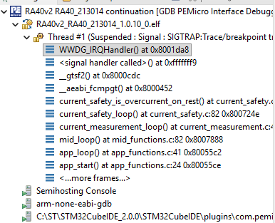

It is curious. I have never enabled the wwdg but it is being triggered.
2025-12-01 4:07 AM
So, again, instrument your code to see how it gets there.

What you see in debugger could indicate that you are falling in an interrupt handler which is not defined. What I mean is the interrupt that leads you there is not necessarly the WWDG interrupt.

The debugger screenshot hints that you're using semihosting. if so your program cannot run without debugger. Make a "release" configuration without semihosting.
