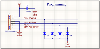

Thank you for the answer and for testing my code.
Indeed, I progressed with the tests and ended up discovering that the implementation is working, however, it only works when I turn the primary power off and on. It seems that the recorder reset is not enough STLINK-V3SET (Circuit below).
Any idea what it could be?

2025-03-21 2:34 AM
Sounds to be one of the "inadvertently running bootloader/mapping system ROM at 0" cases.
In the non-running case, heck/post content of SCB_VTOR and SYSCFG_MEMRMP.MEM_MODE, and check where does program counter point to.
Check/post BOOT0 arrangement. Check/post option bits. Try to change SCB_VTOR upon startup to match the FLASH address.
