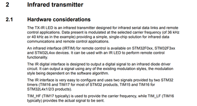

Hi @Lanceh,
Please refer to the Application Note AN4834 specifically section 2 Infrared transmitter which contains information that clearly explains the IRTIM and RC5 protocol
Thanks.
