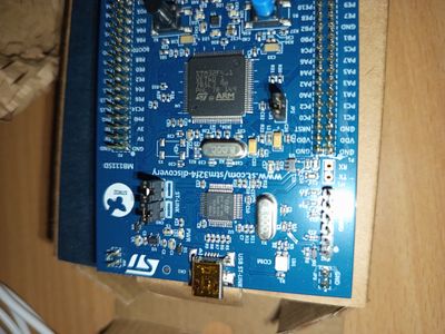

Hello @Duc_Tran and welcome to the ST community,
Make sure all these components in the RED recatngle are available on your board:
If you are using CubeMx or CubeIDE could you please attach your ico file?
