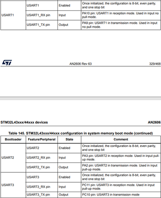

Is it possible to flash the firmware using GPIO pins via UART? I would not want to use microUSB anymore. This is because my company is building a tool with other components and it will be difficult to open the packaging every time to connect the microUSB and flash.

Hello @Abijith
The bootloader is also available on the UART interface for the STM32L432KC:
Best Regards.
