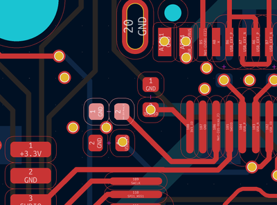

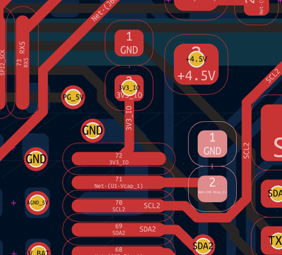

My Layout:
Vcaps:

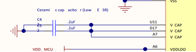

@QuirinS wrote:
each Vcaps (2x) has a 2.2uF capacitor (alltough i am not sure about its esr)
For Vcap pins, you need just 2x 2.2uF and all VCAP pins need to be connected together.
Please refer to the AN4938 "Getting started with STM32H74xI/G and STM32H75xI/G " and check again your hardware based on the recommendations and the reference design provided in the section 8 Reference design.

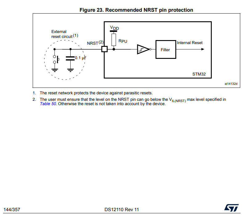

You don't have NRST on the debug connector, and a I don't see the recommended capacitor on it.
As @mƎALLEm said, see the hardware development app note, AN4938.
Also the datasheet:
You could also look at ST board schematics, for reference.
2026-04-03 9:48 AM
Hi @mƎALLEm , whats the pin U11 in your pic ?
2026-04-03 9:52 AM
U11 ball / TFBGA240 package:
