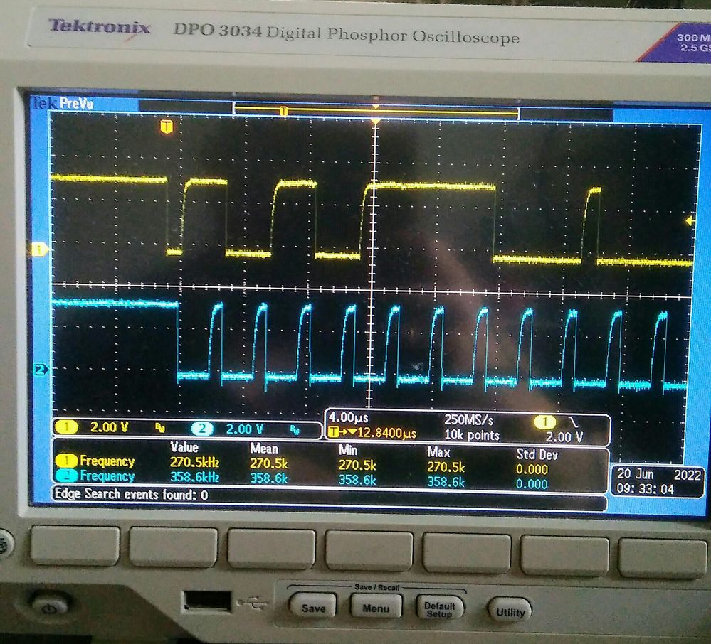

When I connect Eeprom to the ST Nucleo stm32l031 demo board, I see a completely normal waveform.

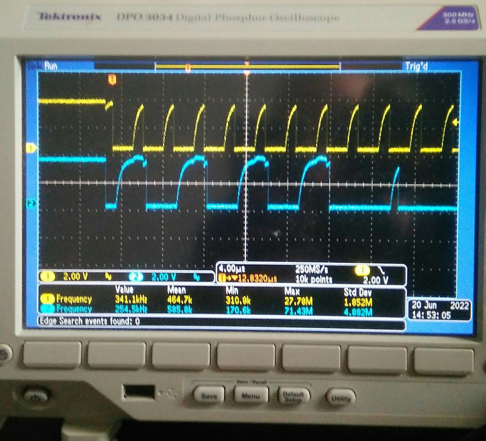

When I connect ST Nucleo STM32L4R5 to the demo board, I see very slowly rising leading edges of the signals.

It seems, on the second oscilogram, that signal voltage is nearly 4V. Are pullup and memory chip connect to correct power tree?
