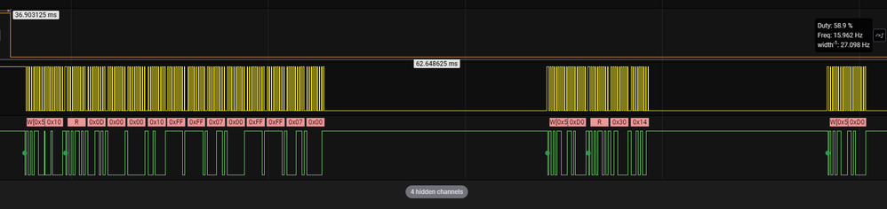

I currently use a STM32G070 with external touch sensor component usuing I2C interface.
This component aloow me to communicate with it only during a ready window and this window is automatically closed after a delay without communication or a I2C STOP.
So, I try to communicate multiple time during this window (transmit and/or receive) using "HAL_I2C_Master_Seq_Transmit_IT" and "HAL_I2C_Master_Seq_Receive_IT" function.
The I2C frames are always composed of 2 step:
In both case, when I transmit the register address, I use the "I2C_FIRST_FRAME" option.
For the second command, I use "I2C_LAST_FRAME" or "I2C_LAST_FRAME_NO_STOP" option depending if I must close the communication or not.
The first command is always sending in background task of my firmware and the second is send during the "HAL_I2C_MasterTxCpltCallback" interrupt callback.
But I have a problem to a read - read - write - read sequence (always without I2C stop). All i OK for the read - read sequence but for the write, I always have only the register address and not the data. And I don't have the next read sequence.
Maybe I don't use the right options but I don't know.

A little more information.
If I use "I2C_FIRST_AND_NEXT_FRAME" option with the first step for the write sequence ("HAL_I2C_Master_Seq_Transmit_IT" function), the data are send but I not able to make another write sequence.
If I check into the HAL librairy in the "HAL_I2C_Master_Seq_Transmit_IT", I see a difference in the I2C registers just after the call of "I2C_TransferConfig" between the 2 options (even if the parameters are the same).
The ISR register is different.
With the "I2C_FIRST_FRAME" option, I directly have the STOPF bit flag (STOP detection flag).
With the "I2C_FIRST_AND_NEXT_FRAME" option, I have the TXIS bit flag (Transmit interrupt status) and the STOPF is only set when the data have been send.
