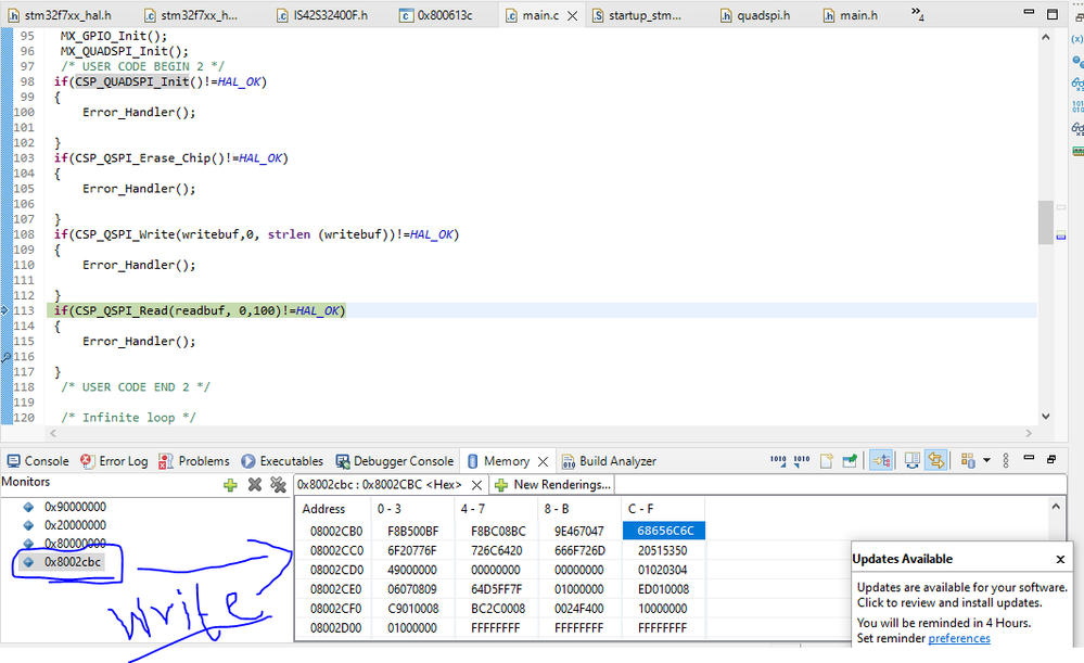

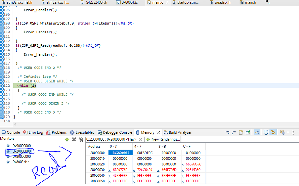

Now i have working in Image processing project . Forst i tried to uplad the code for normal flash memory but array size is big so memry is overflow .After i move QSPI external flash memory .
I have write the code is working fine but one specific doubt
my External memory region is 0xC000000 but my write data store 0x80002cbc and read data is 0x2000000 region
I send code and snap so anyone give the solution

You assign pointer do the string in Your Flash memory so the string is located in the Flash at address 0x80002cbc. Next You read to the buffer which is located in the RAM. That's all.

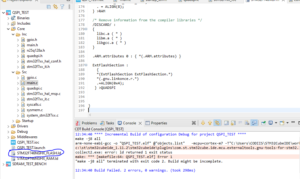

ExtFlashSection : // i am adding this five line but is error
*(ExtFlashSection ExtFlashSection.*)
*(.gnu.linkonce.r.*)
.=ALIGN(0x4);
} >QUADSPI

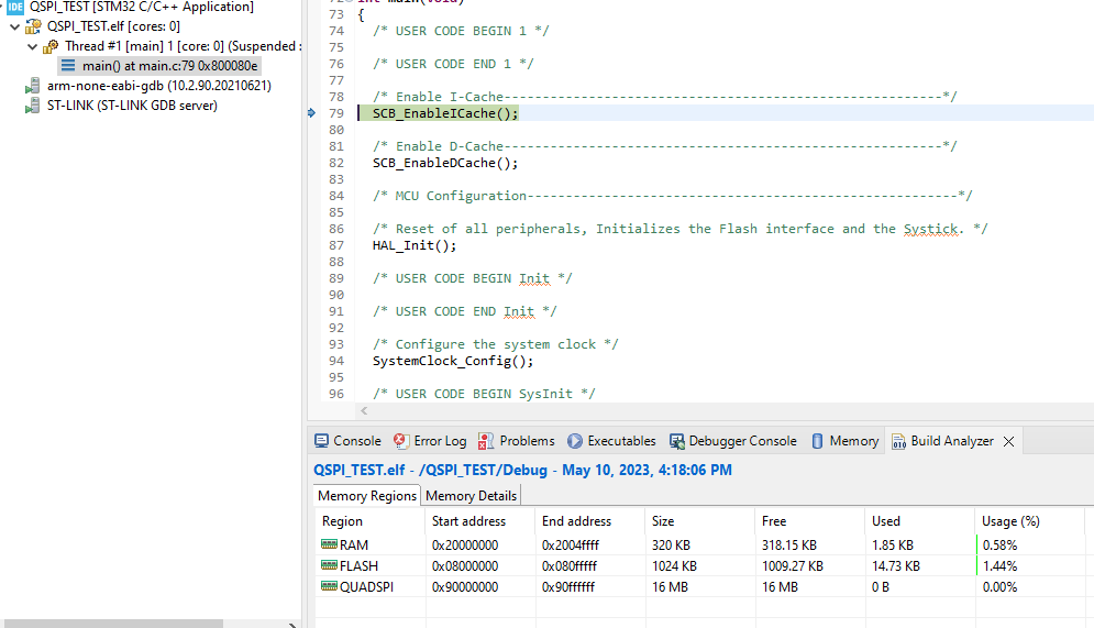

}have one doubt sir ..how to write the QSPI external flash Actually I am configure the stm32f746dico board in build MT25QL128ABA1EW9-0SIT IC chip but is not working fine ..
First of all I have write the QSPI program and debug the program but not show QSPI memory window then I have write the flash id but is show error .I have send the program and snap pls give your support and help

Please see this post: https://community.st.com/s/question/0D53W00001LRf5pSAD/need-external-loader-file-for-stm32h743iit-and-mt25tl01g

Hai sir,
Actually I clear the error for you reference link .
but i try to write my data throught QSPI flash memory but data is store to flash memory
So i have send my and and snap and give the solution any example code or tutorial

Screen shots not real helpful.
If you get errors,show the errors, starting with the first ones.
ST provides an External Loader for the DISCO board, but you might have to select in the related user-interface / settings, probably that for the debugger. #NotMyTools
Don't erase the QSPI in the application if you've put data there in the build / download process.
Why / where are you transferring control too? Where is the application code?
Expect to have to bring up the memory, and memory map it, before you can see it in the debugger or memory windows.
