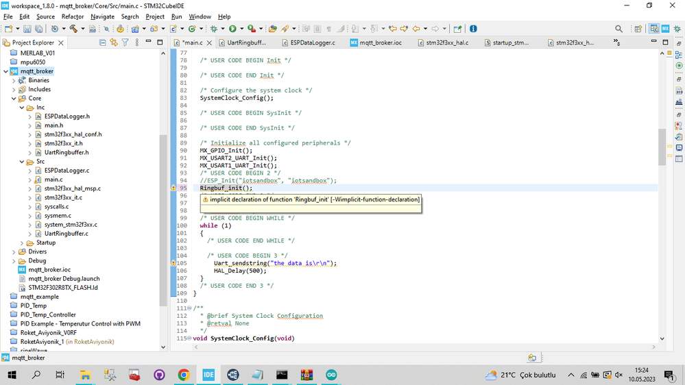

Error suggests you're missing an include file defining the interface expectations of the function

you are right. Thank you.
