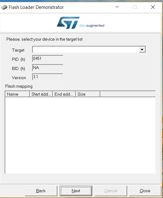

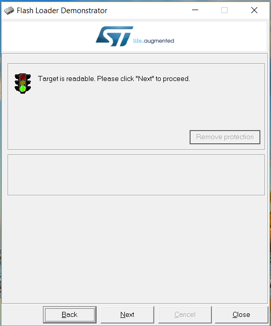

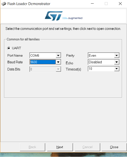

Tried how? Your screen shots, while interesting, don't tell be much about the STM32 end of the issue.
And what USART are you connecting too and how?
You're using BOOT0=High to get into the System Loader?
According to the documentation the VCP uses USART3 PD8/PD9, and that's not supported by the System Loader.
Can you use the ST-LINK?
Can you use the User USB and DFU mode?
AN2606

Thank you for your reply,
I am using USART1 PA10/PA9 with serial to USB converter according to AN2606.
Yes. I have connected BOOT0 pin high.
