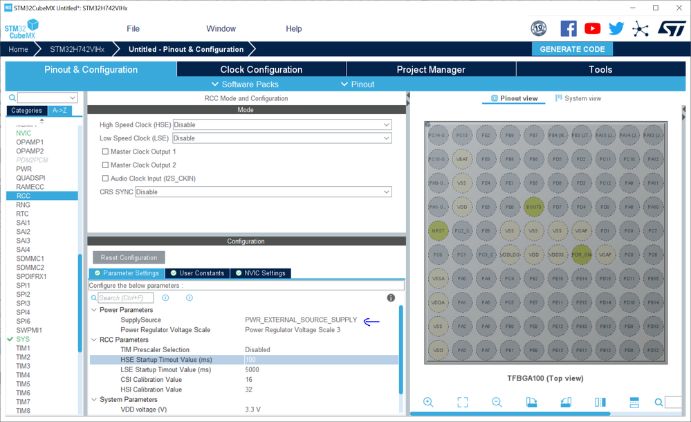

You can find the configurable parameters in CubeMX in this screenshot
