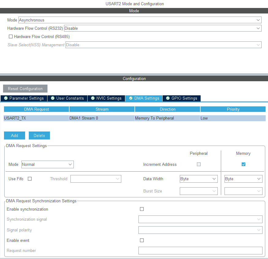

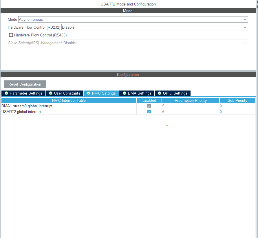

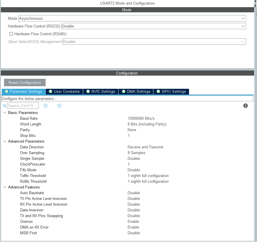

I'm trying to enable USART transmission (TX only for now) via DMA, but when I call HAL_UART_Transmit_DMA, the transfer doesn't seem to start at all and HAL_UART_TxCpltCallback is never called.
I've configured everything through CubeMX: enabled USART with DMA, enabled FreeRTOS, and enabled interrupts. Without DMA, transmission works fine using HAL_UART_Transmit, but when I switch to HAL_UART_Transmit_DMA, nothing happens.
I can't figure out what the problem might be. Does anyone have any suggestions?

2026-01-04 1:33 PM
Are your DMA buffers in non-cacheble regions? Can you share your MCU, .ioc and MPU config?

2026-01-04 10:59 PM
Hello @Andrea Verdecchia ,
Did you try to debug, put a breakpoint and check the data in the buffer?
2026-01-05 3:34 AM
I looked at the two examples you sent me, but the first one configures everything manually in code without using CubeMX—I haven't tested it yet but I will—while the second one only configures DMA for RX and doesn't set anything I haven't already set. I double-checked my code, removed FreeRTOS in case that was the problem, and also tested sending via interrupt with HAL_UART_Transmit_IT and it works. The only thing that's not working is DMA. I'm new to the ST environment and I'd like to understand if I'm missing something in the CubeMX configuration.
2026-01-05 4:18 AM

2026-01-30 5:33 AM
Where are your DMA buffers pointed at? Launch a debug session and hover with the mouse over the buffer and tell me where it is located. If it is located in the cachable SRAM, you will get issues with stable readings and interrupts.
Please share maybe also your Ioc that i can help you better as well as your linker file, your dma buffers need to be placed in a dedicated area.
I need more information about your setup, but currently i suspect the lack of memory protection/ dedication is the issue.
