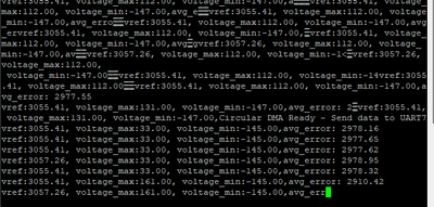

So here is the outline of my code. I'm getting data every 5 seconds (example data: "vref:2975.12, voltage_max:30.00, voltage_min:-1219.00,avg_error: 4136.04") via UART and i transmit it again to view it in putty via ST Link (USART3). Problem is some of the data is getting corrupted, i'm attaching the Putty terminal output.
I have verified the input, using logic analyzer and it's correct.
Here is the code, can you help me identify what i might be doing wrong

Looks like a timing problem.
> ... and i transmit it again to view it in putty via ST Link (USART3).
Not sure if you are aware, this happens within interrupt context (HAL_UART_RxCpltCallback()), thus blocking the same UART interrupt, and other interrupts with identical and lower priority.
2026-01-12 5:58 AM - edited 2026-01-12 5:59 AM
Output a clock signal to verify timing is correct between the chip and whatever is receiving on the other end.
Do a bound check on i before writing.
2026-01-14 12:14 AM
@TDK @Ozone Guys it was not a software problem.
This is what was happening , i have two STM32H723ZG , one is nucleo and other is custom. I'm sending data from custom and sending it to Nucleo H723ZG via UART (UART7). From there i'm sending it to USART3 (ST-Link Virtual COM port) , so i can view the data in PuTTY in PC.
Earlier the problem was data getting corrupted on transit, so i tried different things and nothing worked. Then i just plugged the STLINK of custom board to my PC, then the data starts arriving correcly, if i unplug the ST-Link data starts to corrupt again.
When i use a logic analyzer to read from custom board, i have no issue.
What could be the possible issue?
see how the data arrives before and after plugging ST-Link
Custom board is powered by battery, It is getting 3.3V at VDD pin
2026-01-14 12:24 AM
I'm pretty sure this is the problem.
Removing the serial adapter (VCP) on the remote site does not affect the Tx side of the MCU, but surely the Rx side.
You would need to check and validate the timing of your application.
