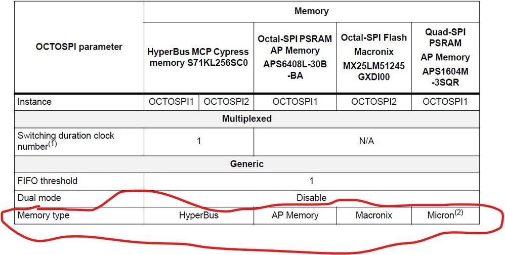

1.in the manual "AN5050", What's the meaning of "memory type"? Does this mean that OCTO only supports these four types of memory chips? The flash I used is "IS25LP064A", Does the OCTOSPI support this flash?

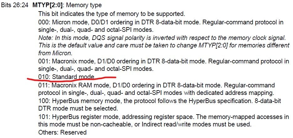

MTYP: See RM of your MCU, in particular OCTOSPI_DCR1.

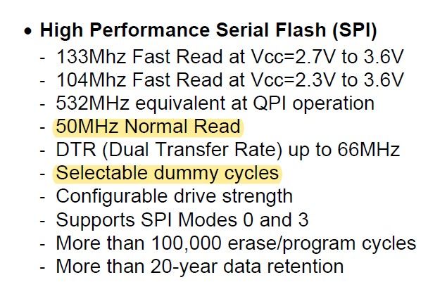

Clock: Well, take OCTOSPI kernel clock (as given by the clock tree and
OCTOSPISEL bit in RCC_D1CCIPR) and calculate the required divider to yield a clock below the flash's limit (50MHz in your case). If you're unsure (there are a lot of settings involved) check the resulting clock with a scope.

For SPI flash the memory type (macronix vs. micron) is relevant only in Octal-DTR mode, it affects the byte order within one clock cycle.
As your chip is only SPI or Quad-SPI, the setting of type (macronix/micron) doesn't matter, i.e. MTYP should be 000 or 001.

The IS25LP064A should be workable.
These other "Type" relate how the signalling works/sequences, and which player its most like.
Winbond, ISSI, Infineon should all work

ok, thanks, what's the meaning of "MTYP", and how to set it to "000" or "001"?

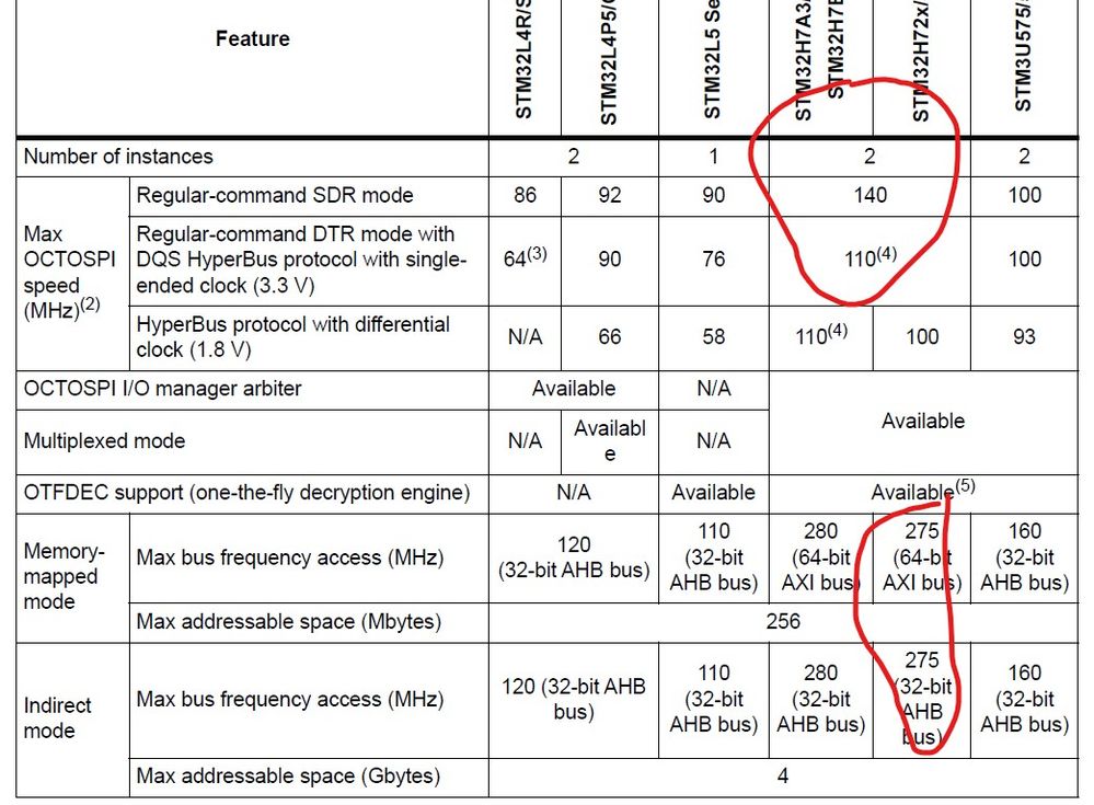

another question is how to set the frequency of OCTOSPI? what's the difference between "Max
OCTOSPI speed (MHz)" and "Indirect mode"?and according to my flash, how to set the OCTOSPI CLK correctly?

"As your chip is only SPI or Quad-SPI, the setting of type (macronix/micron) doesn't matter, i.e. MTYP should be 000 or 001.", for my flash-IS25LP064A, I think I should set MTYP to 010, do you think so?

Hello @rsun.1,
Adding to all the contributors' comments, and for the frequencies presented in the Table 2 of the AN5050:
