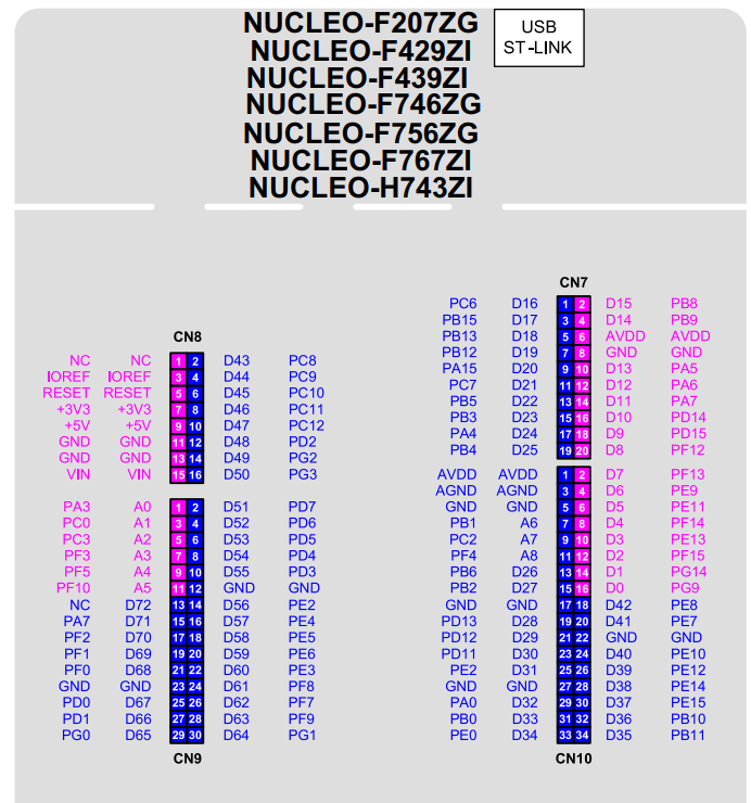

The Nucleo has two rows of holes on each side. There you'll find the pins not routed to the black connectors.

Just have look at the board's manual - you will find all the connectors and config options there.

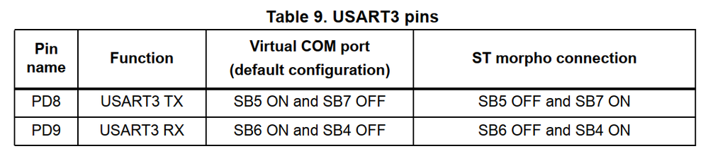

I am actually new to stm32 and perhaps there is
something am missing. The user manual says UART3 is linked to PD8 and PD9 but on the extension connectors diagram, I cant find PD8 and PD9.
2023-01-22 4:25 PM
Got it thanks
