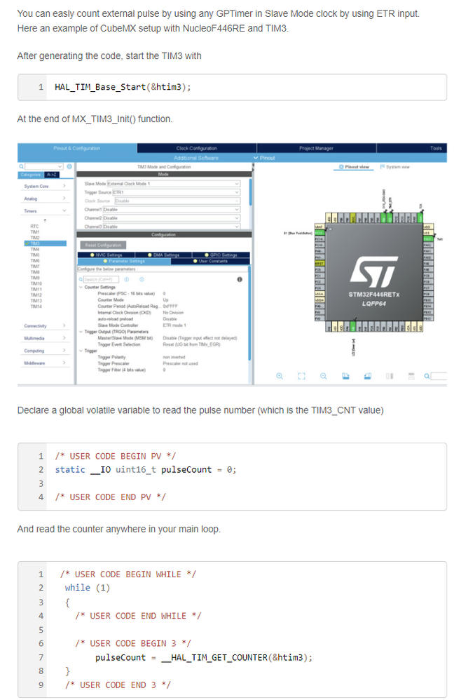

Input Capture (IC) captures (copies) the timer counter to a timer channel register, this is not what you want for counting pulses. You want to use ETR (external trigger) mode creating counter pulses from an external pin and read out the timer counter register.
Have seen projects on the web, your search engine will find them.
hth
KnarfB

Thanks KnarfB,
Found a post detailing how to use ETR to count pulses. It worked a treat :beaming_face_with_smiling_eyes: :
