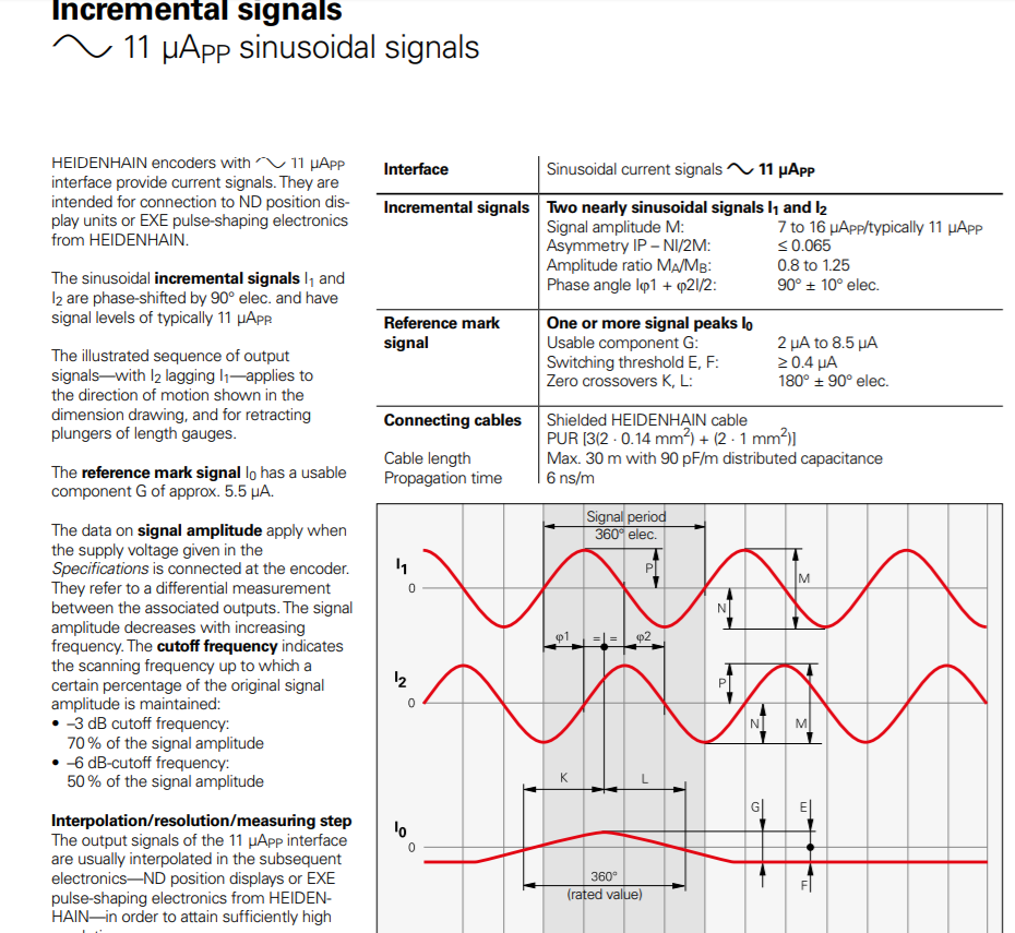

With my STM32F103C8T6 I would like to receive the 2 signals I1 and I2 from the picture below in order to convert to

signal and interpolate them such as the file attached in order to have a decent precision. For example, in my case the step of the wave is 20 microns so I would like to interpolate it by 20 in order to have 20 pulses of 1 micron.This is an optical ruler on a milling machine so the ruler can travel in both ways with numerous direction changes

That picture suggests that what you have is a Resolver:
