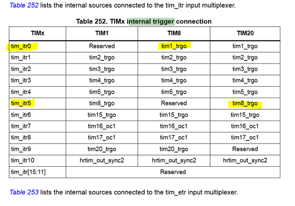

2023-11-14 12:04 AM
The original question's problem usually lies in incorrectly started slave timers. The point of slave-mode controller in Trigger mode is, that when trigger arrives, the TIMx_CR1.CEN bit is set, that's all. In other words, you are not supposed to set that bit "manually", and you are also not supposed to enable the master timer (set its TIMx_CR.CEN) before all slave timers are set up. A good way to check if this all is fulfilled is to set up everything except setting master timer's TIMx_CR.CEN, and at that point read out and check all timer's registers if they are set as expected.
When it comes to something which can't be get working simply by clicking in CubeMX, Cube usually gets more into way than helps, as the various Cube/HAL functions have intertwined behaviour and consequences of calling each function may not be fully inferred just from that function's name, and they don't map directly to functionality described in the RM.
You may want to explore the path Cedric outlined above, but IMO even then having an understanding how the hardware works makes life easier. Such understanding is achieved by writing a bunch of simple experimental programs working at the register level, or even just experimenting with the timers' registers in debugger, and observing the resulting behaviour.
