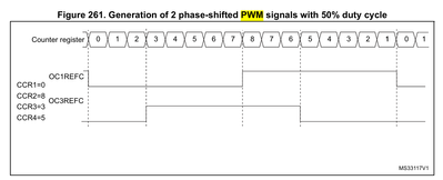

This is what I understand from the graph on page 754 in the RM. But it is not allowing me to change the phase shift while still maintaining 50 % duty cycle on both waves. When I print my CCR3 and CCR4 values, they are exactly ARR apart, which would make me think that they should produce a 50% duty cycle wave. But they don't.

Are you trying to duplicate this?
Note that CCR3 and CCR4 are not ARR apart.
Should select CCR3 to get the desired phase offset and then set CCR4 = ARR - CCR3.
