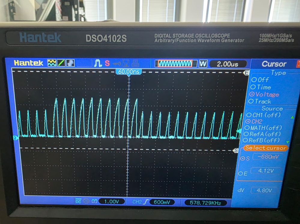

}I already had the output hooked up to an oscilloscope and the output waves look correct. However, when I run this code, nothing changes on the LED strip. I just want to ask if there is something wrong with my code here, or could there be any potential hardware issues I did not think of.

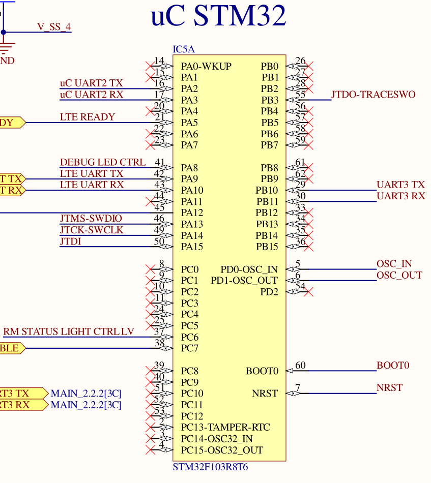

Please show your schematic.
@Beartama wrote:I already had the output hooked up to an oscilloscope and the output waves look correct.
Please share scope screenshots - someone may be able to spot something...

@Beartama wrote:when I run this code, nothing changes on the LED strip.
Do you see changes on the scope?

2025-09-03 2:56 AM
RM STATUS LIGHT CTRL LV is the LED strip.
The high spike is for bit 1 to be sent to the LED, and the low spike is for bit 0. The high spike is high for 0.75us and the low spike is high for 0.375us, these are according to the spec of WS2812B.

That doesn't show how the STM32 is actually connected to the LED strip, nor the LED power supply.
@Beartama wrote:Please share scope screenshots - someone may be able to spot something...

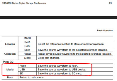

you missed:
@Andrew Neil wrote:
If your scope has a screenshot facility, please use it - this will be far better than trying to photograph the screen!
Your scope does have that facility:

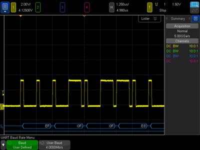

Anyhow, that waveform looks terrible: there should be clear pulses with clean edges, and consistent height; eg,
from: https://www.pjrc.com/2017/10/

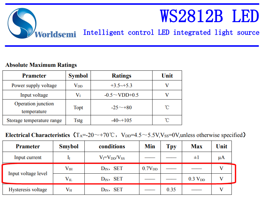

From the LED datasheet:
You haven't shown what your VDD is for the LEDs but, if it's 3.3V, that would mean that the minimum 'High' voltage is 2.3V.
In your scope trace, the short spikes aren't even reaching 2V, and even the tall ones are marginal.
