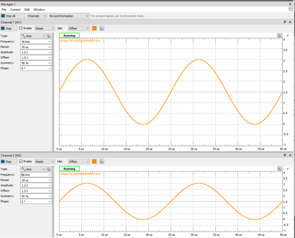

snapshot of my function generator
I am using timer triggerd ADCs 1 and 2 with DMA + continous mode, each taking in a sinewave because i need them to be sampled simultaneously with very minimal distortion.

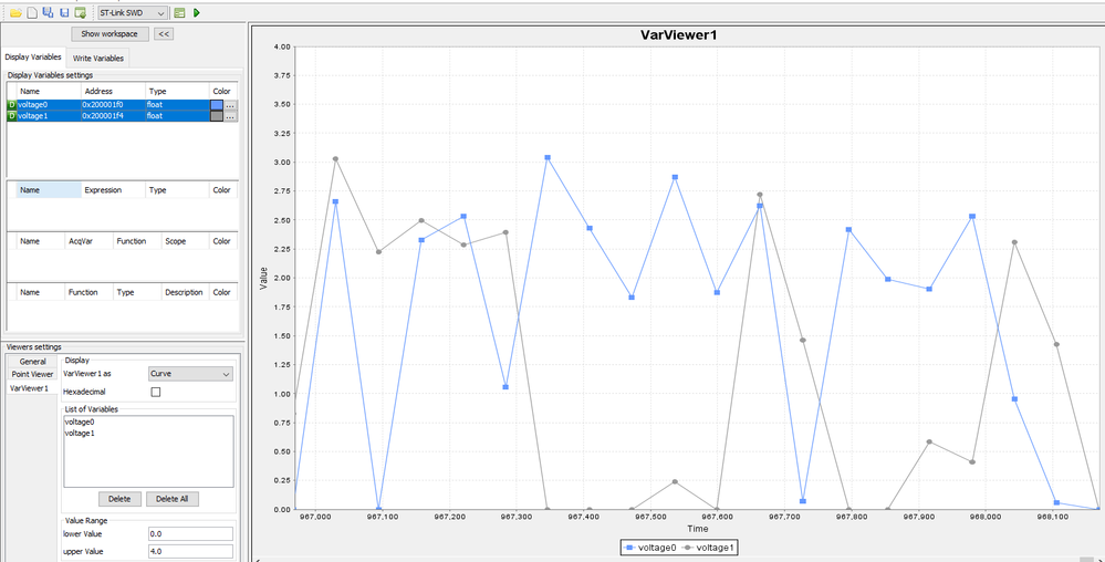

When i convert the DMA'd values back to voltages, i can't recreate the sinewaves again, with the STM Studio.
snapshot from STM Studio.
I use the formula to convert my adc values back to voltages.

Well, i didn't want to concentrate on the signal processing aspect. I simply wanted to get the signal representation in the digital form, then i can apply whatever methods available. FFT, or even apply FIR filters. But first, i want to get the signal in the digital domain. Thats the gist of the matter. Forget the signal processing aspect of it for a moment.
2023-05-26 7:48 AM
Try first with a much slower sinus wave so that reconstruction is straight forward. Reconstruction at the Nyquist edge is tricky.
