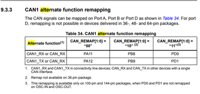

how to interface CAN protocol with STM32F103rct6tr if it is possible just give any documentation

As you can see in the DS5792, you can interface CAN with the STM32F103rct6tr using the CAN_RX and CAN_TX pins (PA11 and PA12 but it can be remapped by software to some other port pins such as PB8 and PB9 or PD0 and PD1).
To understand more about how to configure and use the can use the CAN protocol on this MCU, take a look at the chapter 24 of the STM32F10xxx reference manual.
