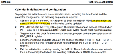

This is what RM0455 Rev 10 says about clock and calendar initialisation:
"To program the initial time and date calendar values, including the time format and the
prescaler configuration, the following sequence is required:
1. Set INIT bit to 1 in the RTC_ICSR register to enter initialization mode. In this mode, the
calendar counter is stopped and its value can be updated.
2. Poll INITF bit of in the RTC_ICSR register. The initialization phase mode is entered
when INITF is set to 1. It takes around 2 RTCCLK clock cycles (due to clock
synchronization).
3. To generate a 1 Hz clock for the calendar counter, program both the prescaler factors
in RTC_PRER register.
4. Load the initial time and date values in the shadow registers (RTC_TR and RTC_DR
and configure the time format (12 or 24 hours) through the FMT bit in the RTC_CR
register.
5. Exit the initialization mode by clearing the INIT bit. The actual calendar counter value is
then automatically loaded and the counting restarts after 4 RTCCLK clock cycles."
This is very good advice, it's a pity the HAL programmers didn't take it.

Rob
@TDK wrote:> Using HAL to set the time and date takes around 112 us when using both the data and time functions which provides plenty of opportunity for loss of time/data sync especially if there are other processes that can extend this out.
The RTC is stopped during initialization. Initialization is started in HAL_RTC_SetDate and exited in HAL_RTC_SetTime. As long as you're calling them with a consistent date/time, there's no chance for desync.
The documentation should be improved to note that they must be called in the correct order (first HAL_RTC_SetDate then HAL_RTC_SetTime).
Look at the RTC_ISR_INIT bit to see how this is handled.
