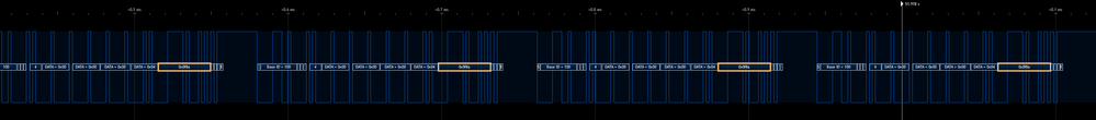

Example with a duplicate frame five times:
Captured with Ikalogic SP209i and find attached data. You can analyze them with ScanStudio free software tool.
After, the receiver sends another message in reaction. So the message is really received once...
Do you have an idea?
Thanks in advance!
