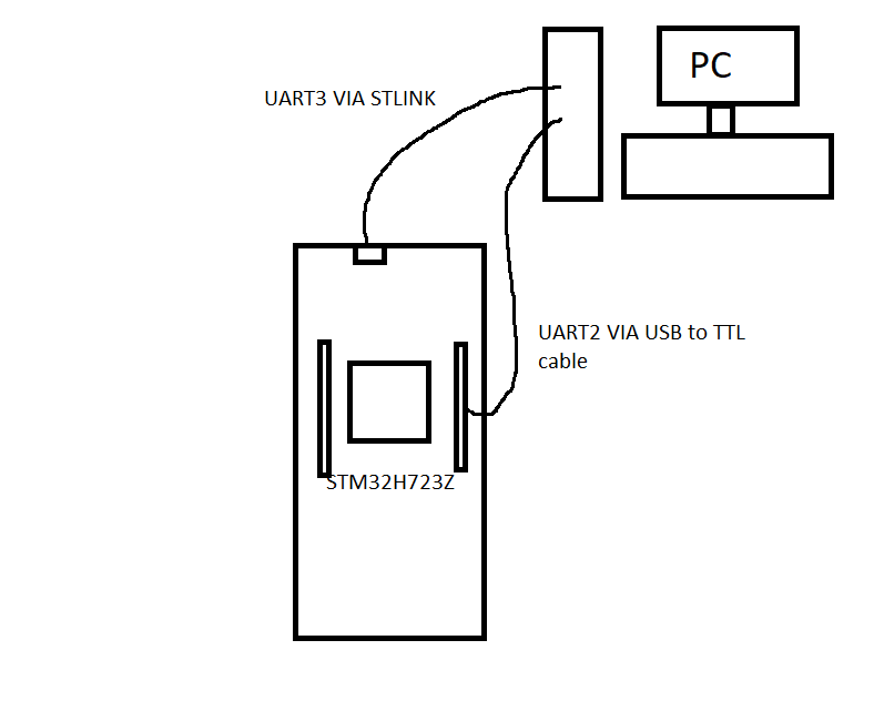

So I am transmitting data at 7MB/s over UART to a PC. Currently, it uses UART3, which is connected to the ST-LINK. When I view the data on the Windows PC it is fine but every now and then the received data is wrong, and it misses quite a few transmissions. I believe the error is from the UART data passing through the ST-LINK. (Please let me know if UART3 does not actually pass through the ST-LINK when transmitting)
To check if this is true I am using a TTL to USB cable (https://thepihut.com/products/usb-to-ttl-serial-cable) to send the data to the PC. This all works fine, and when I use a Raspberry Pi, the data can be viewed and is correct. However, I am struggling to replicate the result on a Windows PC.
When I connect the TTL to the USB cable to the PC it appears as a USB-Serial-Controller, and I need to assign it a driver. I've tried the STM drivers to make it into an STMicroelectronics STLink Virtual port, but this does not work. So I was wondering if anyone knows what driver is needed? I've looked into FTDI drivers, but they don't seem to work either.
That kinda strains credulity, but whatever..
With the ST-LINK you're going thru two UART connections, asynchronous serial isn't known for reliability or speed, you'd need to use some kind of protocol to manage flow, integrity and retrying.
Using a SiLabs or FTDI USB-to-CMOS Serial would involve less intermediaries, perhaps speeds to 1Mbps in the normative sense.
For higher speeds perhaps Ethernet, or USB-HS connectivity, using a class of USB device better suited to data transfer in the direction of interest.
I think I'd be hard pushed to get the volume of data you're talking about on to an SD card

7MB/s was working correctly, but it seems the Windows could not process it quickly enough. I swapped to a Linux OS and it still had the same issue.
The options at the moment are:
Thanks for your thought on the topic
UPDATE: I could also be using the wrong cable. It seems that the cable I am using, which I linked above, may be unable to do a high baud rate. This could lead to the error I have found.
