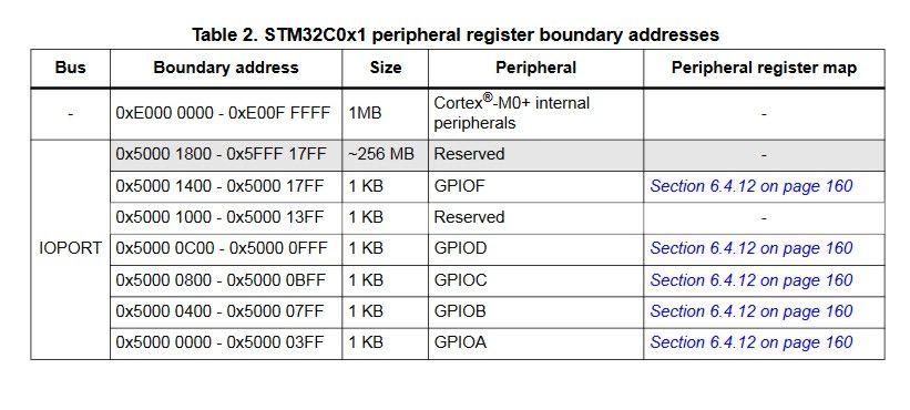

So I found the bug in the HAL firmware. It is in stm32c0xx_hal_gpio_ex.h file. Line 302 has an ill-defined value because this MCU does not have port D and port E implemented.
// original code
#define GPIO_GET_INDEX(__GPIOx__) (((__GPIOx__) == (GPIOA))? 0uL :\
((__GPIOx__) == (GPIOB))? 1uL :\
((__GPIOx__) == (GPIOC))? 2uL :\
((__GPIOx__) == (GPIOF))? 3uL : 4uL)
//new code
((__GPIOx__) == (GPIOF))? 5uL : 6uL)GPIOx port mapping is on the picture from reference manual.
