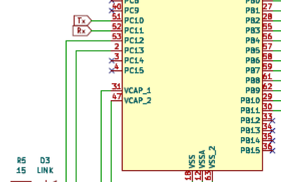

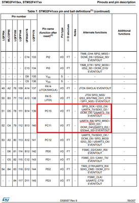

TX and RX here match the datasheet:
https://www.st.com/resource/en/datasheet/stm32f415rg.pdf#page=59

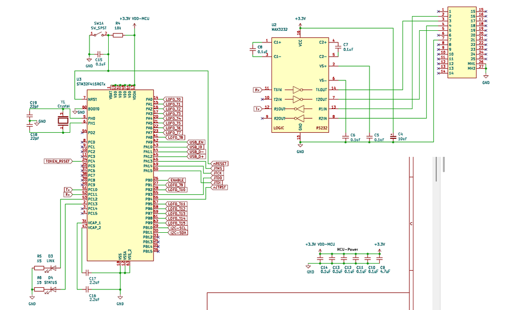

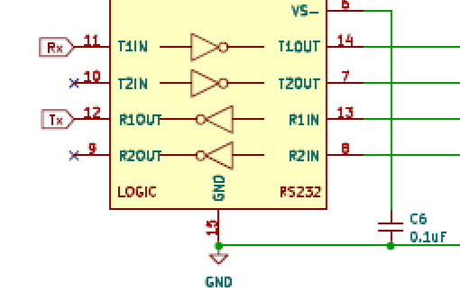

But this is wrong:
RX is an input to the STM32 - so should be driven by receiver R1OUT;
TX is an output from the STM32 - so should drive transmitter T1IN.

This is a custom board. It has not been tried on an ST board. Below is the subset of the schematic with the STM32 and MAX3232 chips.
Parts of this code including the SystemClockConfig are reused from another group. I didn't do the individual bit setting in that function. I'm wondering if something is missing from that, or if the Tx/Rx lines are swapped somewhere, or there is something else wrong. I ended up with this board, and both hardware people who took the old design and modified it to this have left the company.
