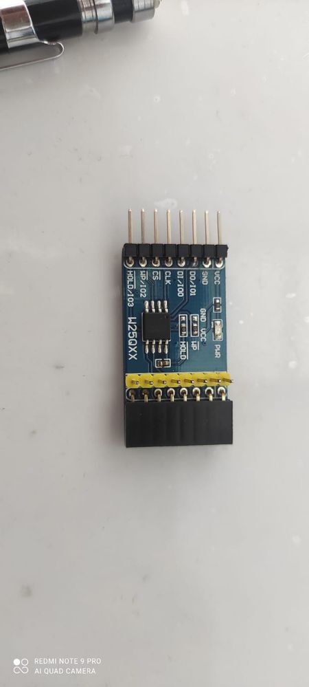

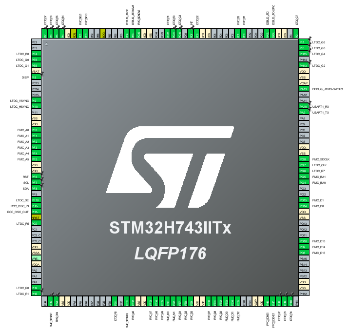

The screen I made with Touchgfx works just fine. But Flash Memory is at 82% and will be full soon. So I need to implement QSPI. I have W25Q128JVSQ Flash and 176 pin STM32H743IITx board. Could you please prepare an MX file (with .ioc extension) for me? I work in a company that carries out an R&D project and I need to finish this job as soon as possible. Otherwise it won't be good for me.

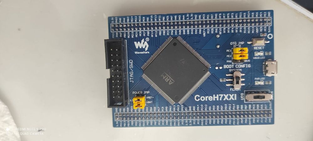

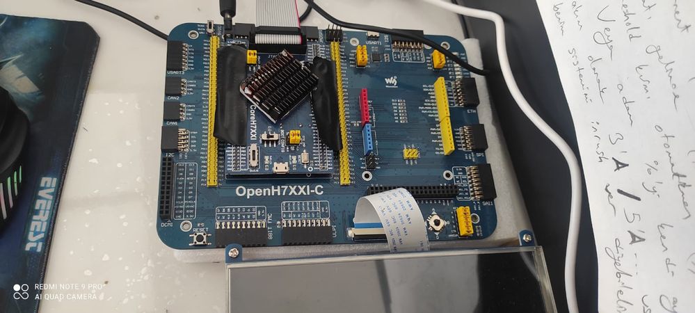

These (4 pictures) are the images of the product, can you please help me urgently?
