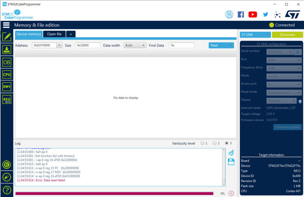

In the last weeks, I was working on running W25Q256 nor flash chip from vendor Winbond with STM32F746 MCU on a custom board. My guideline in this road is ST's how to run QSPI flash video tutorial (5-part video) and of course some genius guys in the community who's helped me a lot to rewrite the functions of QSPI flash (Init, Erase, Write, Memory-mapped). So far functions tested in the Main.c and I can read the pre-written data on the memory. The next step is to generate (.stldr) external loader file and modify Flash.ld file.
according to the video tutorial, I added Loader_Src.c, dev_inf.c, and dev_inf.h files to the workspace but there is a little confusion about flash.ld file that contains memory definitions and all other data and text stuff to assign to specific memory (>FLASH, >RAM, >QUADSPI).
for the point of concern, I use STM32F746 with IS42S32400F SD-RAM connected with 2-banks to MCU and of-course W25Q256 NOR-FLASH.
here I uploaded relevant files for check

2021-01-09 9:15 PM
2020-12-28 12:55 AM

I start a new project from scratch by just configuring QSPI and nothing else, added loader related files, and built successfully. starting CUBEPROGRAMMER and external loader appears with correct values in the list (EL section) just OK along with the tutorial video. but when trying to load sample code has done with success but no changes in address 0x90000000! what is the problem?
external loader generation could have been easier, can't understand why ST doesn't take care of it!:unamused_face:
2021-01-01 5:28 AM
@Community member would you please give me a hand to solve it, I saw your earlier posts about generating stldr file but currently, I am in big confusion!

2021-01-01 9:59 AM
The loader is loaded into SRAM by the programmer, and executes from there.
The linker script needs to output two sections, one with the StorageInfo structure where the programmer pulls the device geometry, name and statistics from, and a program section.
I'm in the process of porting an example to GNU/GCC only, will attach the script here shortly.
2021-01-01 10:17 AM
This is for the H7 platform, but just needs the RAM changed to 0x20000004 for other STM32 families.
I'm not using the interrupts/vectors
2021-01-02 2:17 AM
@Community member I wish you the bests for 2021 and thank you for your reply in these early days of the year
I include your linker to my project and change the RAM address as you mentioned. firstly I got some errors about location counters (_end, e_stack, ...) in sysmem and startup files. I will try to fix them and get back soon.
2021-01-02 7:45 AM
Thanks.
The loaders shouldn't need startup.s or main(), the Init() function should clear any critical globals or BSS space.
2021-01-03 4:05 AM
@Community member with your linker provided, I'm able to read the external memory just for once (I mean, when I loaded generated stldr to CubeProgmrammer and connect, when hit the Read button, the memory reads properly at 0x90000000 but when hit it again...Read Error). I enable Verbosity level 3 and see that the error is because of the Init function timeout (screenshot attached). It seems the overall functions are OK but need minor adjustments. Would you please provide me a Loader_Src file OR help me fix mine:beaming_face_with_smiling_eyes:
I'm looking for your attack after you finished your porting project.

}2021-01-04 10:42 PM
I made some changes in the Init function and finally, it is OK, I checked the loader in st-link utility and there is no error when reading and initializing. But now when sector-erase, it actually erases the coresponding sector but with fail message! I think the next challenge would be making erase functions work. @Community member
this is the working Init function (at least for me):
