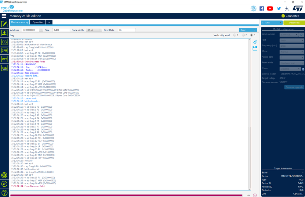

@Community member Unfortunately none of them works. still, has init fail error even when connect/disconnect.
Actually (maybe) it is because of the H7 compatible loader, Mine is F746 instead. As you know, the RAM start address and vector table location are different from H7.

2021-01-09 10:56 PM
@Community member I can't believe it works...Thanks a lot, each and every function are completely OK, saved my life, Clive. ST community is meanless without your efforts man.:baby_angel:
