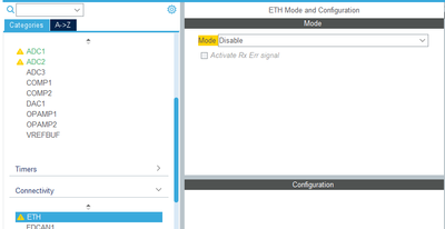

Hi, I am also facing the same problem with the ADC. I want to know If I remove the L1, do I need to provide external reference voltage or I don't have to change anything else.
Can you tell me how to disable the Ethernet in CubeIDE. I attached the screenshot of my try to disable it

Hi, can you please guide me how to power down the Ethernet PHY and disable Ethernet clock via software .
