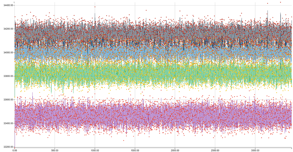

And then I've got the same high-speed (2 MSPS) raw data captures again:
as you see it still shows this aliasing affect, but it looks now way cleaner and more "pronounced" than it was before:

As I've already mentioned in my previous post - you can not identify that this is aliasing of higher-frequency interference IF you do slow sampling. As in this 13kSPS example it just looks like Gaussian noise, because clock drift (PLL jitter) introduces a lot of phase noise to notice any aliasing patterns of 13kHz vs 25MHz interference.

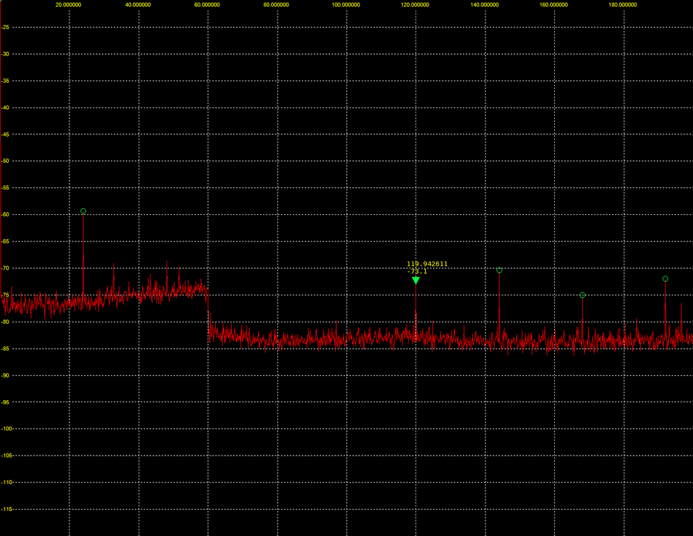

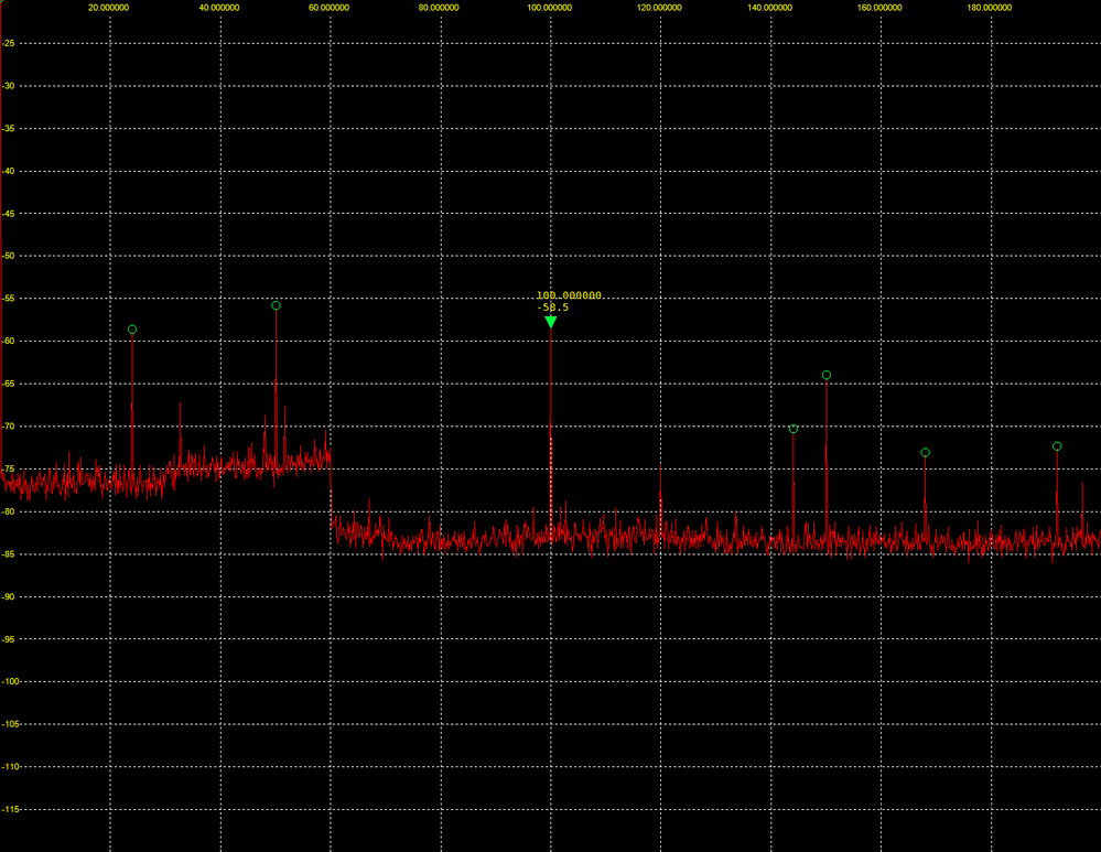

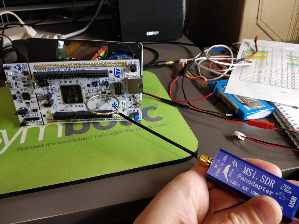

Got my MSi.SDR delivered, so made an H-field probe to see more what spectrum is radiated from Ethernet PHY chip:
Using RSP Spectrum Analyser software, here is the spectrum when the probe is far away from the Ethernet PHY chip:
And this is when the probe is close as shown on the picture above:
So that 25MHz frequency (of the XTAL nearby Ethernet PHY chip) is actually multiplied by 4, so we have 50MHz and 100MHz components in radiated EMI.

After some more researching in SDR comunity I've figured that MSi.SDR while beeing the cheapest radio capable to pickup in kHz band - is not the ideal.
MSi.SDR is a cheap Chinese clone of RSP1 from SDRPlay. It has issues with spectrum output when there are no signal connected (no antennae or probe on its input) - see my first picture of the spectrum in previous post. It has spurs of 24Mhz and some of its multiples (48MHz, 120Mhz, 144Mhz).
24MHz - is the XTAL you may find on MSi.SDR board if you take it apart.
Today for around $100 you can get RSP1A (an updated version of RSP1). It has stellar sensitivity (like 20..30dB lower than MSi.SDR) and as per what i see on youtube reviews - with no spurs.
