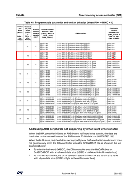

> MAybe the second DMA had to be set like LL_DMA_PDATAALIGN_BYTE (SPI->DR) from source and LL_DMA_PDATAALIGN_HAL_WORD for destiantion (DAC-DHR12R1)?
The names of constants are probably wrong, but that would not work anyway, as the single-port DMA in 'G0 does not assemble/disassemble data, but zero-extends them:
You have two options:
- use 16-bit SPI; for that you'd probably need to switch SPI between 8-bit (for commands to memory) and 16-bit mode, or switch memory-facing pins between GPIO and SPI and bit-bang the command
- use memory as a buffer and a third DMA, storing 8-bit data using the second DMA into memory and picking them from memory using the third DMA and storing into DAC. Timing of the third DMA may be tricky, maybe DMAMUX's facilities could be used for that, I am not familiar with DMAMUX.
