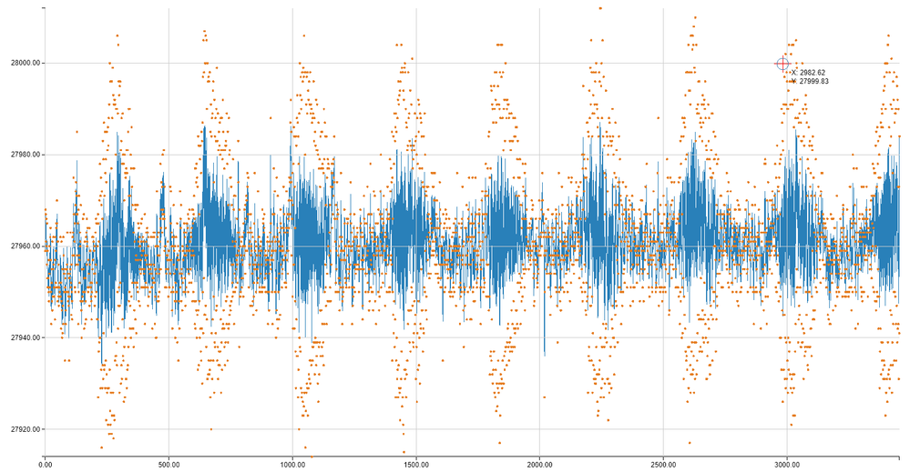

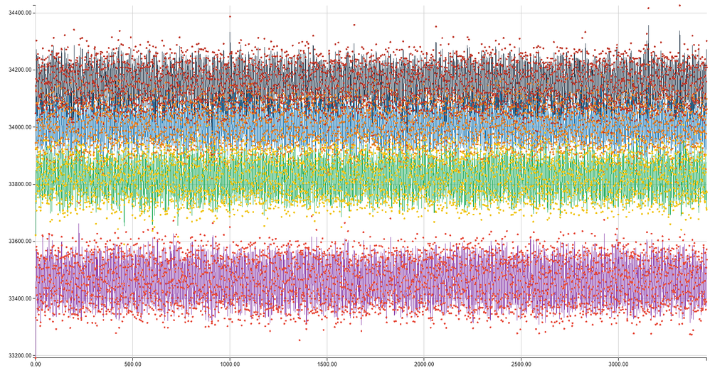

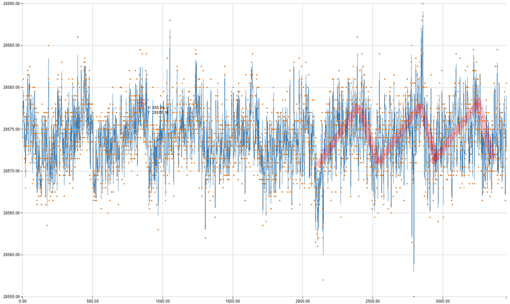

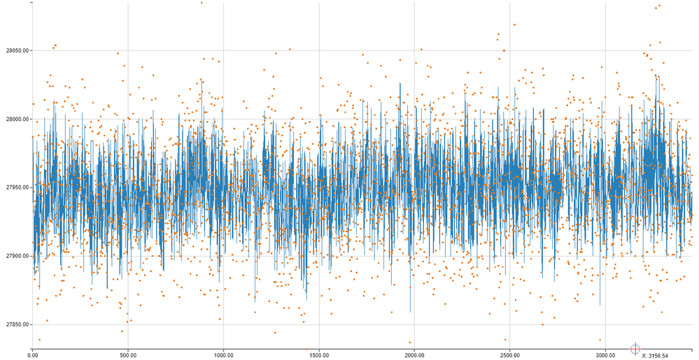

And then I've got the same high-speed (2 MSPS) raw data captures again:
as you see it still shows this aliasing affect, but it looks now way cleaner and more "pronounced" than it was before:

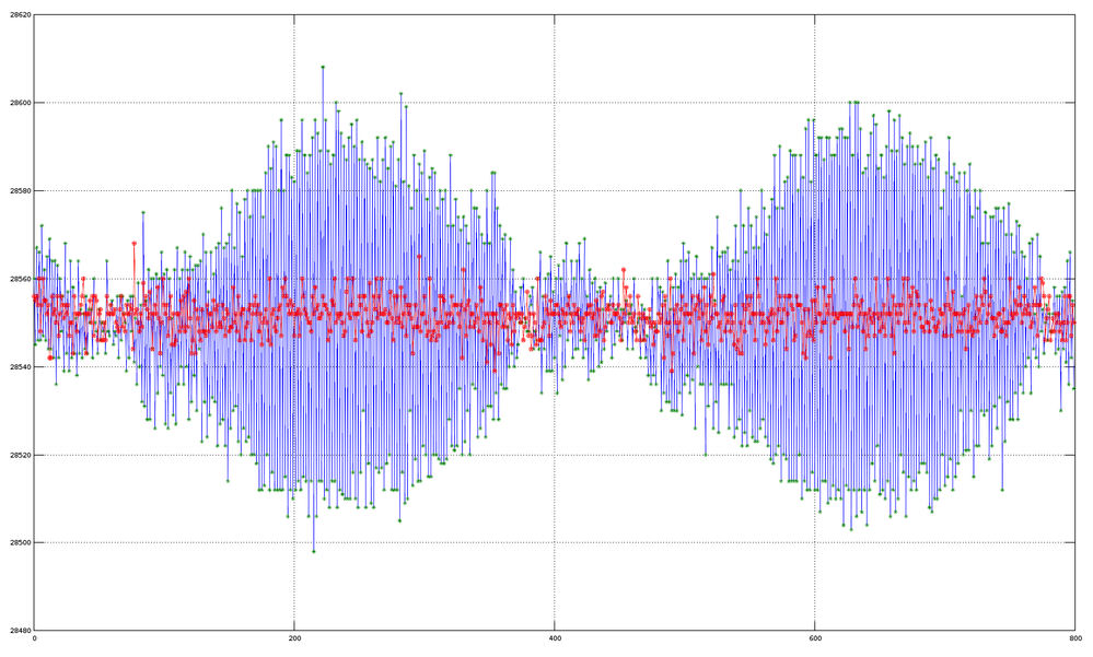

If using moving average filter using 2 samples, it improves slightly:
Trying to run ADC at its maximum sampling speed (5MSPS) did not help to figure out interference frequency, so it is higher than that.

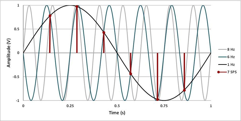

As I've already mentioned in my previous post - you can not identify that this is aliasing of higher-frequency interference IF you do slow sampling. As in this 13kSPS example it just looks like Gaussian noise, because clock drift (PLL jitter) introduces a lot of phase noise to notice any aliasing patterns of 13kHz vs 25MHz interference.
For these who don't now:
ADC aliasing happens when there is higher frequency at your ADC input than the Nyquist frequency (more than 1/2 of you sampling speed). You can not work with this kind of acquired data if you want to do any decent signal processing on it. In all good designs ADC inputs are guarded with good low-pass filters. Here is good example from the web (https://e2e.ti.com/blogs_/archives/b/precisionhub/archive/2015/09/04/aliasing-in-adcs-not-all-signals-are-what-they-appear-to-be)
As you see 6 and 8 Hz signals can not be reproduced properly when sampling at 7Hz, you see that as 1Hz signal on ADC output.

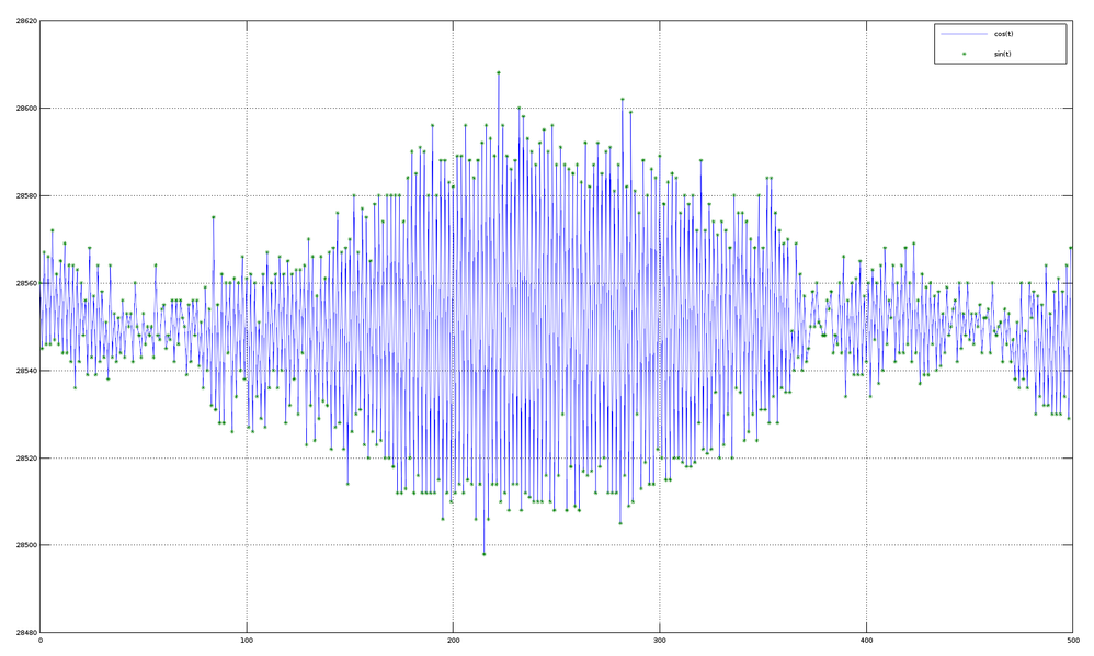

In our case - the parasitic input was way beyond my Nyquist frequency of 1Mhz. If we zoom-in time scale of the first picture and plot it in MATLAB:
The parasitic signal is apparently at 5mV peak to peak range (100 LSB out of 65536 for 3.3V full range).

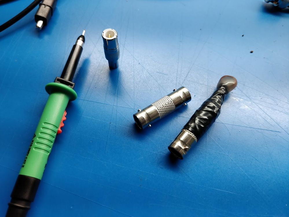

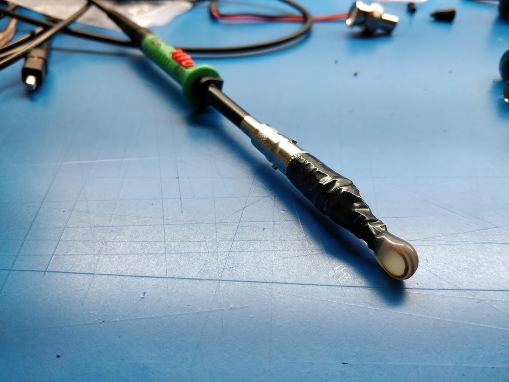

Without having a patience to wait for SDR and semi-rigid coax delivery I've used an oscilloscope probe which came tip-to-BNC adapter. Using another female-to-feamale BNC-connector, piece of copper wire, aluminum foil and electric tape I've got an E/H-probe in like 20 min:
With this contraption I was simply observing waveform on the scope and sniffed the interference source when I've stick it into Ethernet PHY IC package. I was lucky it was powerful enough to get me 5mV spikes on the scope without the need of any LNA.

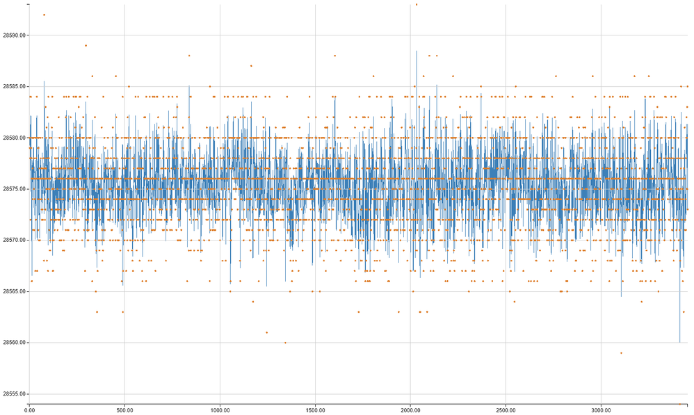

Here is the raw sampling after I've thrown away an L2 ferrite bead. It should actually serve as a filter connecting a +3V3V_PER peripherals supply line to Ethernet PHY circuitry, but apparently interference is so strong that it propagates through the ground, or EMI into the wires connecting my DC-signal source to ADC input(s).
Here is the RAW capture of DC-signal source (AAA battery) after the hack:
And here its overlay (red) with the RAW capture before disabling Ethernet PHY (blue):
As you see - I've got it all well within spec, major half of samples are somewhat in 10LSB peak to peak range, while all of them within 30LSB.

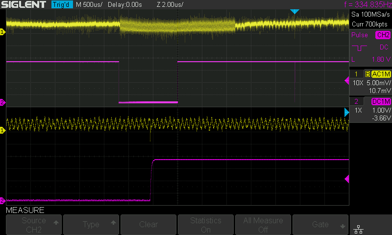

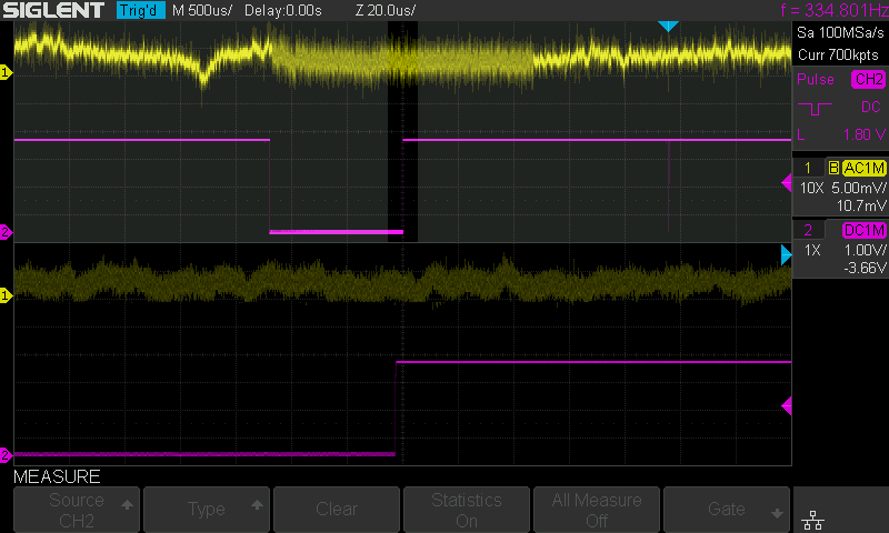

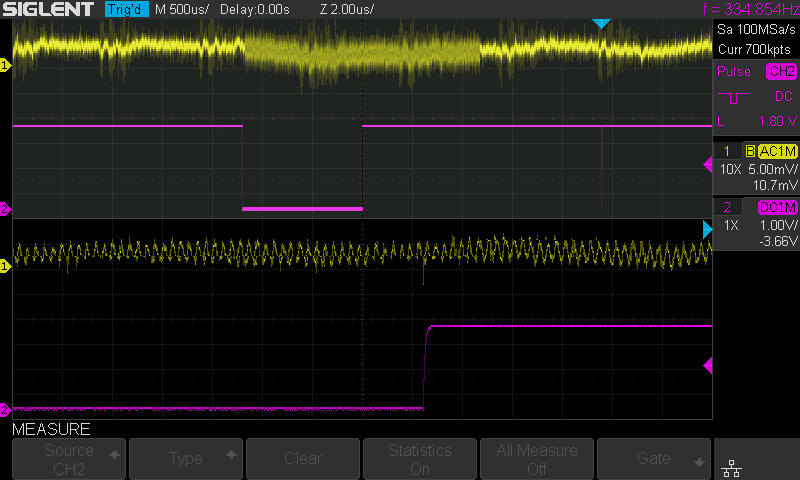

On the oscilloscope images:
So to troubleshoot the problem first thing is to figure out and mitigate all the contributing noise sources.
External battery supply with NO USB connected,:
Here how noisier it becomes with connected USB ground:
And here is the same (with battery power and connected USB) with added electrolytic capacitor on AVDD and AGND pin.

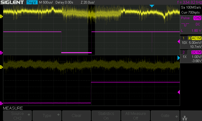

A miserable attempt to improve analog supply decoupling, looks slightly cleaner. But with grain of salt - cap inserted on the line between MCU pins and scope input, so it could be just "LPF-ing" the signal which goes into oscilloscope probe, while the analog supply itself is still noisy:
Here is AVDD line with slighly better zoom in time domain:
Attention - my scope is 100MHz bandwidth, so what you see might be aliasing of much higher frequencies.
Anyway 5 mV p-p fluctuation is likely contributes to sampled values accordingly.
With 3.3V supply on Vref a 5mV noise will result into 2.5mV error of measured signal that is half of sumplu line (1.6V) and that is eqvivalent of ~100LSB. Moreover - for a signal that is closer to 3.3V supply line it will increase to 200LSB.

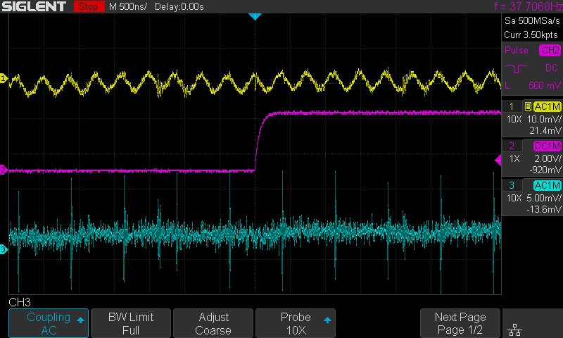

On next scope screenshot the new blue channel is hooked up to one of the ADC channels (pin-header of the Nucleo board). For an experiment I've disconnected the analog circuitry of my sensor and dropped in a pre-charged capacitor. So I get a steady fixed DC input into ADC:
These spikes on the channel line are actual moments when ADC performs "sampling" phase in its "sample and hold" circuitry (latching to charge an internal capacitor).
This seem to be in-sync with fluctuations on AVDD line (yellow). But you see that AVDD level fluctuation is double the frequency than spikes on the ADC channel line - that is because I have an ADC module configured to multiplex between two input channels. So AVDD level sags whenever actual ADC conversion is in progress.

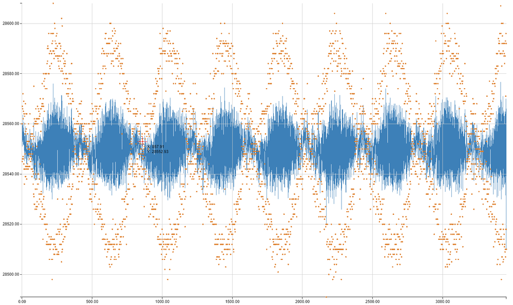

Here is actual sampled data on a channel (orange dots - actual samples, blue line - is a spline interpolation):
It looks like aliasing with higher frequency interference (sampling here is 1.333 Mhz per channel, accordingly ADC triggered at double of that - 2.666Mhz).
