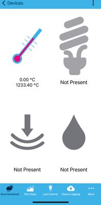

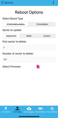

I'm trying to flash ota using the BLE_Sensor iPhone app and I see different interfaces when the app is interfaced with the custom PCB and a NucleoWB55 board. The picture with the OTA config tab is the Nucleo board. The other is the custom pcb w/ modified BLE Sensor firmware. See the attached images.
Does anyone have any recommendations on how to alter the BLE_Sensor example to make flash OTA work? Or any other recommendations in general? I have looked at several step by step guides.
