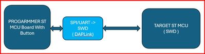

For , "Again, look at DAPLink: that will show you how to have one microcontroller program another."
Are you talking about Following Scenario ? Just confirming if we r on same page.

@bsuthar wrote:Are you talking about Following Scenario ?
Not really sure what you're saying there?
My point is that DAPLink includes code to enable one microcontroller to drive the SWD lines to program another microcontroller - so that's the part you need to extract.
