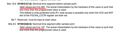

2025-03-24 7:37 AM
This is a known issue in the FDCAN spec and it was already internally reported on the ticket 193478.
From the reference manual RM481/page 2575:
page 2571:
The correct bit times:
For Nominal bit time:
- NTSEG1: between 1 and 256 (* tq)
- NTSEG1: between 1 and 128 (* tq)
For Data phase bit time:
- DTSEG1: between 1 and 32 (* tq)
- DTSEG2: between 1 and 16 (* tq)
So the example is correct.
As you are using Classical frame you need to set only the Nominal bit time.
Hope that answers your question.

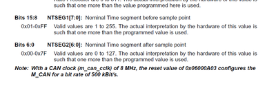

2025-03-24 8:44 AM - edited 2025-03-24 10:24 AM
I don't know which Bosch spec you get that screen shot from, but you need to refer to the M_CAN.
This is a screenshot from BOSCH M_CAN spec (page 23):
