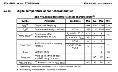

Here is an example using DTS, the Digital Temperature Sensor
Regarding the performance of the DTS : Datasheet - STM32H562xx and STM32H563xx - Arm<Sup>®</Sup> Cortex<Sup>®</Sup>-M33 32-bit MCU + TrustZone<Sup>®</Sup> + FPU, 375 DMIPS, 250 MHz, 2-Mbyte flash, 640-Kbyte RAM, math accelerators Page 215
If better error is required, you can also use the ADC and using the ATS in next step.
Hope it helps you, STOne-32.

it is on the 4th row , from -7 to +2 degree Celsius , DTS measures Tj, junction temperature at die level .
