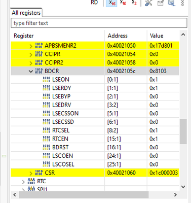

2025-03-24 2:11 PM
This is the BDCR register when PA2 is acting as a clock output.
2025-03-24 2:18 PM
Same BDCR when PA2 is not a clock output.
2025-03-25 3:47 AM
OK so LSCOEN is 0, which appears to indicate that the problem may have some other root than LSCO being active.
